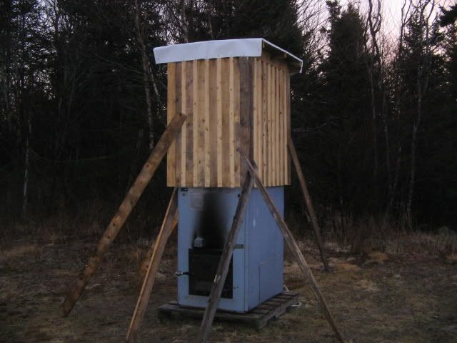

Today I ripped boards to screw over each crack. I decided to go with the board and batten construction style. I made a small fire in the fire box today. It will help dry things out a bit. The smoke was not going into the smoke house because I have not yet decided whether or not to take and put the pipe on back of the furnace and then pipe it in into the smokehouse or drill a few holes on top of the smoke box inside the smokehouse and cap off the pipe flue on the furnace.
What way would you folks think would be best for me to do this?
I will appreciate some help deciding this. Would it cause a problem by cooling the smoke off with the pipe on the outside?
Here is some photos of the amount of smoke coming out of the smoke hole on the furnace without a fan or anything controlling the smoke.
Tomorrow I will start screwing the strips of wood over the cracks. There is a few more things to do on the outside of the smokehouse yet and I will do that as quickly as I can. I am looking forward to being able to use the smoke house. I have some trout that I would like to smoke. That will be my first test with this smoke house.

Looking good raymond , I would pipe it into the back at the bottom then vent at the top in front, that would draw the smoke up and forword , then if you need more venting you you can use the adjustable vents on each side, :roll:
Just a thought, Controll heat at bottom, Controll smoke @ top vents. :?

The idea of the piping from the flue pipe into the bottom of the smokehouse for the smoke and venting is what I actually was thinking also. Do I need a damper in the smoke pipe going into the smokehouse? Also, just to make sure it is clear for me, are you saying to put a vent pipe with a damper out through the roof on the end that has the fire box door? That is what I was thinking. I am thinking a 4" pipe with damper and a chimney cap. I believe we are on the same page.

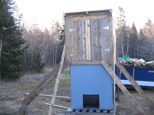

Here are a few pics that I had on the camera from between Jan 30th. to Feb 8th. Haven't felt good enough to do anymore. Friends have offered to finish it for me but I would rather finish it myself later on. I thanked them anyway.
The roof has aluminium sheeting on it. I may put some sort of insulation board on the outside later on and finish covering it with the same sheeting as I put on the roof at a later date. I still have the Chimney(Exhaust) pipe with a damper to be installed yet and I need to purchase some thermometers sometime. Where is a good place in Canada to be able to buy thermometers? They tell me to get a regular BBQ/Smoker Thermometer with a 2.5" shaft and to get a digital thermometer with to probes, one for the meat and one for the interior of the smoke house.
