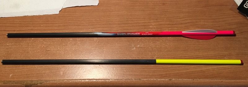

Here’s my first foray into making my own custom arrows! Tricking out some older pink crested Black Eagle executioners. So far here’s my first process and will update while preforming the process!

Looks pretty good to me! Remember what works, and what doesn't, you'll get better every time you make some. Have Fun! :wink:

Arrows look good. Just out of curiosity, by using arrow wraps, will that raise the arrow up just enough to cause any problems with string alignment?? I tried that and it looked as though the arrow was up higher... I was not going to try that! Also, I would think that the wraps would become torn up, after repeated shots. My 2219's that I have shot many times, are scratched up a bit... I really like arrow wraps, but was not sure if I should use them.
Exocet 200 & Stryker Katana 360 - Easton 2219 magnums - Flex Fletch SK300 vanes - TruGlo red dot sight - Munch-single post quiver mount - D. Miller-quiver mount - 8 pt. Flemish string - 125 gr. DRT Dirt-Nap BH - Lumenok lighted nocks
Posts: 11243
Re: Fletching
Post by Boo » Tue Nov 14, 2017 12:07 pm
Wraps are not thick enough to raise the arrow out of the arrow channel.
If you damage one vane, the whole wrap and other 2 vanes have to come off. Not only that but wraps are no fun to remove. With a lot of shooting, wraps will look terrible.
The only real benefit to wraps is that it's easier to get a vane to stick to it. No fancy cleaning with acetone. But the vanes come off much easier than when they are glued directly to the shaft.

I only use wraps on my hunting arrow setups for visibility reasons only! I’m colorblind so I need every visual aid I can get!
