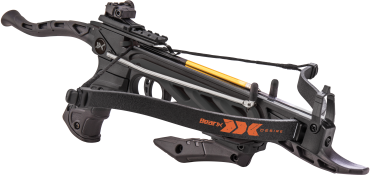

Somebody is reading this forum ….. after I posted this my Dad got an email from someone at Bear Archery saying they heard I asked about a youth bow that could be used for hunting.
This recurve comes in two models that are 2.35 pounds, 10" width, 60 Pound DW and 175 FPS. It is $50 with peep sights or $70 with a Red Dot. It has a cocking device that works by pressing a button and using the butt part like a lever. It does not have a full butt stock. A small person could rest it on their forearm or use a rest for the front of the bow. If you use 16" or 14" bolts the FPS goes down. It comes with short bolts that are like 300 grains with field tips. You can't use a broadhead on those because they do not extend past the rail. With the right bolt and broadhead you could effectively deer hunt out to 25 yards, so they say. Then they say it is intended for target shooting. Well, for target shooting this seems okay but for hunting I would have to see what velocity a bolt at least 300 grains can go. I used to shoot my vertical bow at 128 FPS and I killed deer with it at 20 yards and even got pass throughs. This has potential. Too bad they didn't put a full butt stock on it. It is a step in the right direction.
