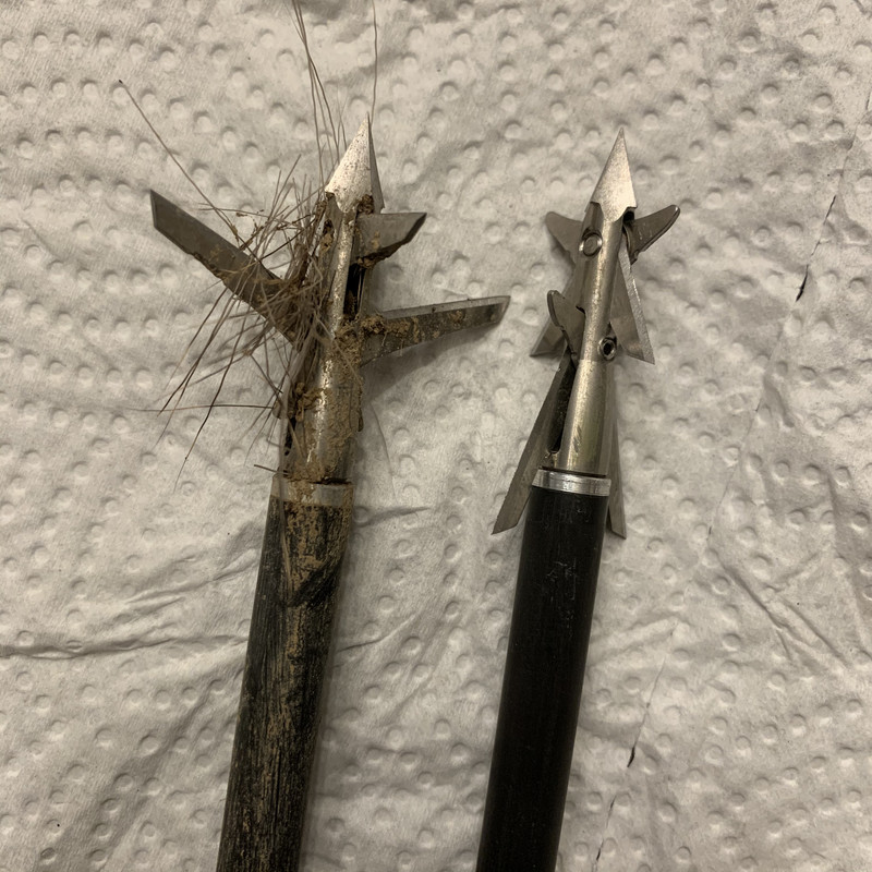

I've run with 125 grain Spitfires from my 380 for years.
Single banded (I know they say you don't need to).
Only once had a premature blade development - this fall, with the offshore production of that broadhead.
Sent the rest back along with a note I will be seeking something else.
Still have enough of the USA made ones on hand, and the parts to rebuild to last a year or three.
Then I will be looking...

I tried rage hypodermics with my bulldog 400.
I could barely hit the target at 30 yards. Had to be opening early
I now use swat crossbow a4 broadheads.
They use a rubber band to keep the blades closed.
They shoot exactly as my field points ...

I'd love to if I had any. If someone wants to mail me a head, I'd be glad to send it downrange and report the results. Seriously, PM me for a mailing address.
Nope, well it does have the stirrup from the SDS but the rest is removed. The R.E.D.S. and air brakes remain.
I made the mistake once of using a head with last years' band on it. I watched through the scope as it dug into the dirt at the deers feet.Normous wrote: ↑Thu Mar 19, 2020 10:51 amI might add that using fresh dental bands in important. Bands degrade when exposed to air, heat and moisture.
Take a look at SWAT broadheads, especially the A4, X MAG, Vector and the 2020 MOAB. I tested them at almost 490 FPS the same way you did and they did NOT open.

My pack of Swat Vectors came in the mail today and I remembered a few old heads I had stashed in a box that would make an excellent group for another day of testing.
Today's lineup includes a cheap eBay Chinese made 2-blade Rage clone from about 8 years ago, an actual 2-blade Rage chisel-tip, one of the original Rage 3-blade versions and a Swat Vector. All heads in these tests are the 100 grain versions.
As a reminder, this is the launching pad. A Micro Suppressor 400 TD that I guess you can consider unsuppressed.
First up today is an original un-fired Rage 3-blade 1.5" cut.
Launched with extreme prejudice...
Well would you look at that! The original Rage 3-blade gets it done even though its a decade old.
Further inspection of the target face shows that it made it to the target closed, then opened on impact.
The rubber ring broke on impact and part of it was laying in front of the target. Not a bad showing for a model that I don't think is made any longer.
The second subject is a slightly newer version of Rage. This one is a two-blade chisel-tip 2" version. I missed the before photo, because it got downrange in a hurry.
This one didn't fair as well as the old 3-blade version. Wide open on arrival.
Since I missed the before photo, here it is again for a second trip. The first trip was with the band only. This second trip will be with a new band and include the "shock collar" as well. I can't recall if this version required them or not.
Away she goes...
And this time it arrived closed as it should be.

Third test is the new Swat Vector 4-blade broadhead set for maximum cut (1.75"). Before firing, I can tell that this head will stay closed. The band is unlike any I've used. While the band does have some give, it gets very firm quickly.
Solidly launched...
And it arrived closed as expected.
It arrives closed, but don't expect a large entrance cut. It essentially enters closed. That seems to be the price you pay for solid containment for any over-the-top deploying broadhead.
It is definitely a mean looking head.
It deploys so hard that the backs of the blades are dented when they contact the cut adjustment nut. You can barely see the dents in the photo above, but can plainly see them here. I'd probably plan on replacing the blades after each shot if they are fired at this speed. It may not dent as bad at slower speeds or with a more forgiving/softer target.
The harsh deployment even caused one blade to dent the adjustment nut.
And finally we close out with a cheap Chinese clone of the original Rage 2-blade. I'm not certain I ever even fired these at targets much less hunting with them. The quality was visibly poorer than the actual Rage heads.
Given the same express treatment...
Huh? It actually arrived closed!
And it opened when it should, albeit slightly less than fully open on entry.
