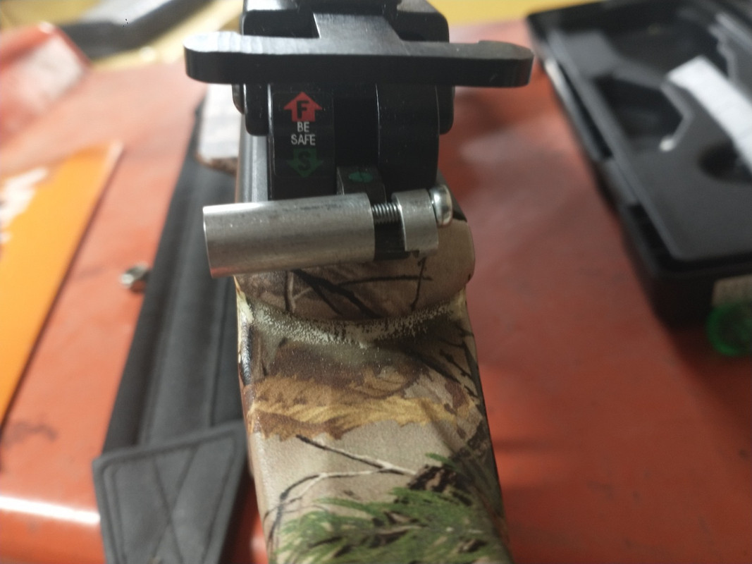

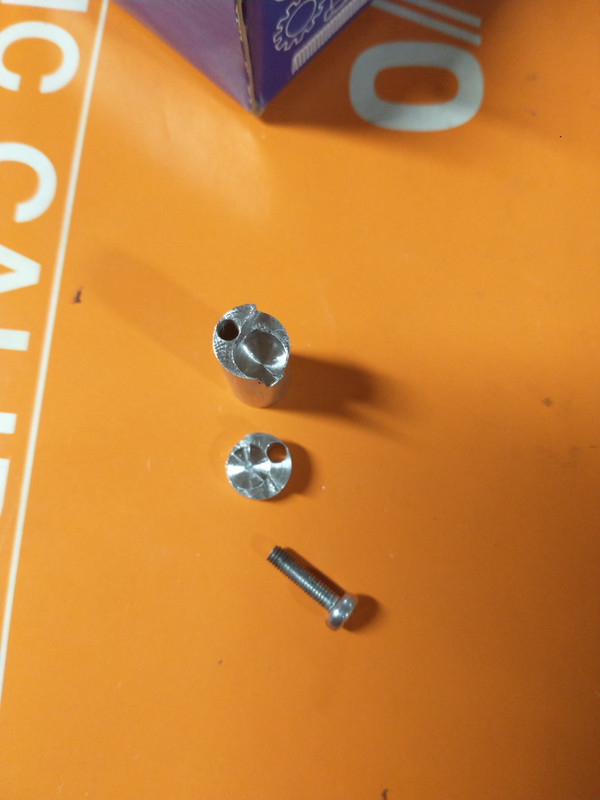

I built two different versions to try on a Micro 355, the first was from 3/8" aluminum rod and used an M3 screw to hold it together. There is very little clearance between the stock and the safety lever when in the down position. It did tilt a bit when tightening up.

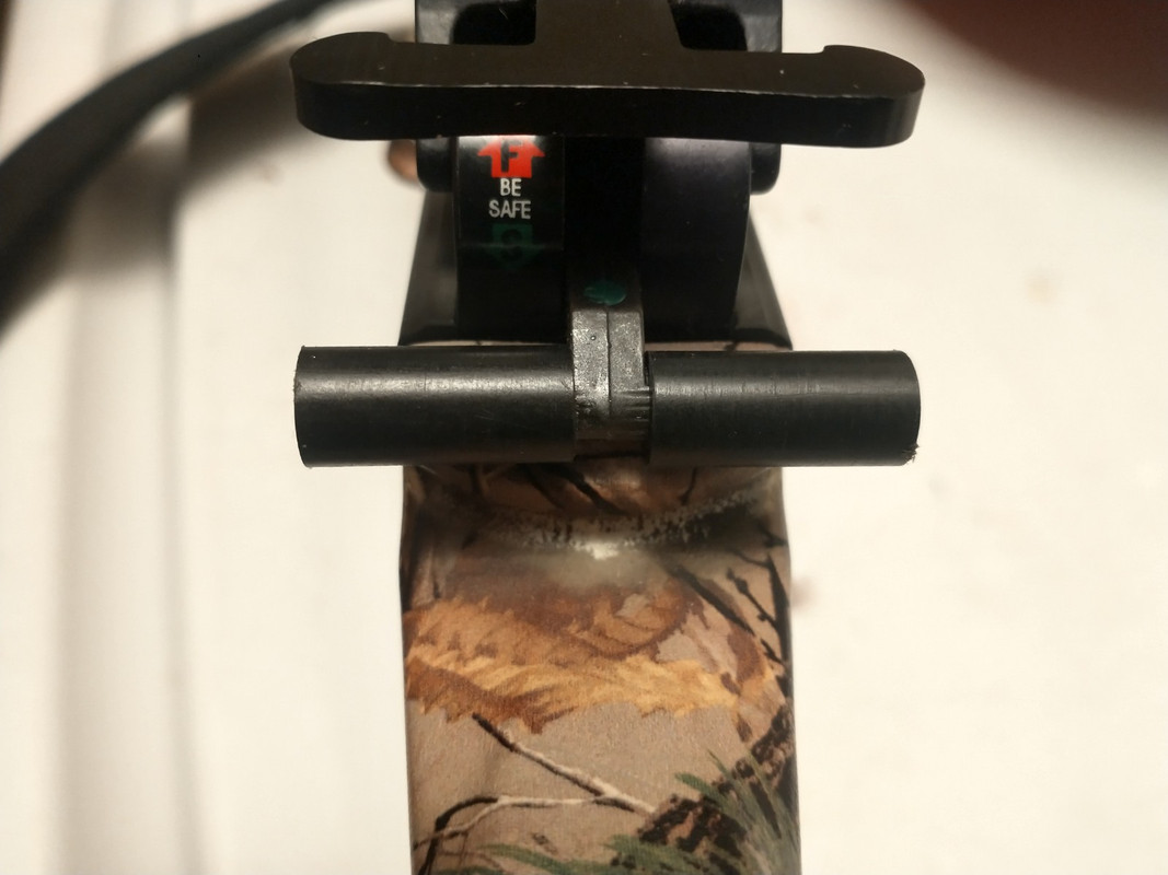

The next one that I tried was made from 3/8" plastic rod, the knurled part measured around .245" so I dropped down to a letter C drill bit that was running around .242" for the hole. I drilled it near the edge of the spacer to be able to rotate it and maintain clearance on the bottom. It is a slip fit onto the round parts coming off of the lever.
If you wanted to install them in a semi permanent fashion you could always add a drop of epoxy before pushing them home. It does not seem much easier to snag than the ADF extension, although if you are wandering through really brushy stuff then there is the possibility of getting it flipped to fire, so if you do decide to add an extension due to wanting to make it easier to use, then watch it for snagging accordingly.
