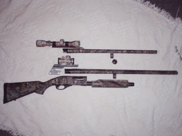

Remington makes a couple different variations of a rifled barrel, but if you say it comes with a pre-mounted scope than the one you are looking at must be a cantilevered barrel. (go for it!!)
One option is to use the bracket that attaches through the trigger pins, that is the one just above the receiver in my picture. the other way is with a cantilevered barrel (far superior), like the short barrel (top barrel)in this photo. Once the scope is installed to the cantilever you can take it on and off with minimal affect on POI, switch back and fourth from smooth-bore to rifled with ease.
As far as quality goes, I use a cheap Redhead scope on mine and have had no problems, the gun will easily do 2" groups out to 125 yards with cheap sabots, switch to expensive sabots and the gun will do 2" groups out to 200 yards.
Your on the right track, the 870 with a rifled barrel is known to be one of the most accurate slug guns out there, enjoy!
