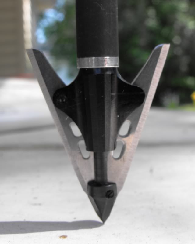

I saw that they have a new 2 blade version with a 1 1/8th" closed and 2 1/16" open so I ordered a pack.
They came a couple days ago so I put them on for a test today.

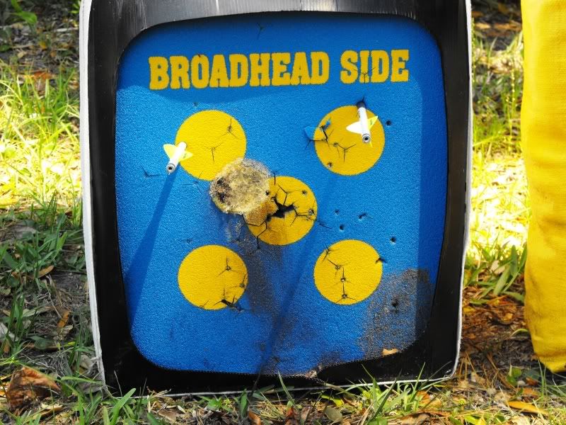

First I shot the field point into the bag target and sighted in for 20 yards then switched to the block for testing shots.
POA on all shots (except for the last shot) was the top left dot.

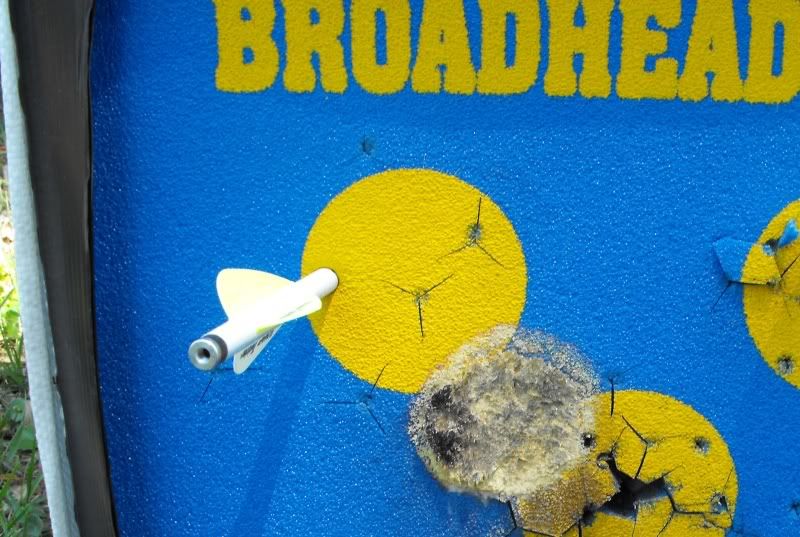

First shot in the block with field point.
Then I put a 2 blde on,POI is 8-10" to the right
I just knew I had pulled the shot by the POI but it felt clean to me so I tested again,same result and again,same result

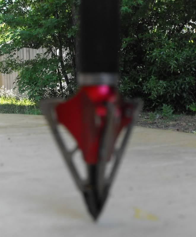

Then I decide to try the 3 blade bloodrunner
That's it right below and to the right of the FP shot,I aimed a little right so I wouldn't mess up my freshly fletched shaft.

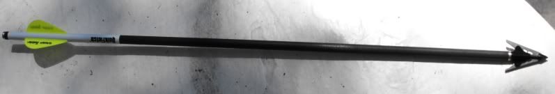

I grabbed a factory fletched shaft and put a 2 blade on it.
I aimed at the bottom left dot on the block
The arrow flew at least 6-8" to the left this time and is as yet unrecovered.

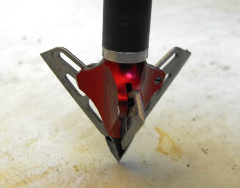

I don't know if they are opening in flight or what but I am not impressed so far with the 2 blade.
The 3 blade however hit's right there with FP's
