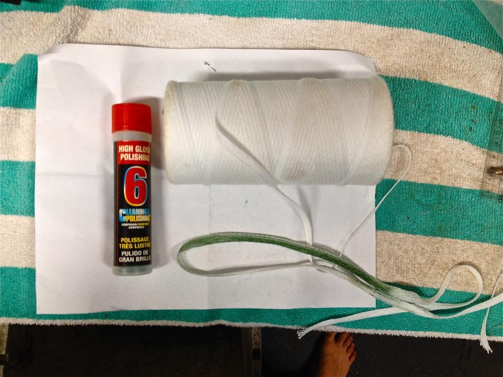

The old saying is there's more than one way to skin a cat, so here's how I skint mine :D
I've got a spool of flat braided cotton string, it's kind of like a real thin shoelace, and some #6 polishing compound which is a super fine rouge for polishing jewelry. I use it on my knives with a leather strop to get a razor edge. Rubbed the compound on the string then hit each leg of the trigger claws a couple hundred times, then did both of them at the same time another 100 strokes, using a back and forth motion like flossing your teeth. Trigger claws shine like new money now :D

It's made by Mibro, it's a stick like a crayon. IIRC I got it at Lowes or Home Depot. With over 400 shots on my 380 the claws were pretty smooth, this just put a nice slick finish on them. I bought it some years ago when I refinished one of my guitars, it shined it up right nice ( sorry, I coulndt resist throwing that in there :mrgreen: )
