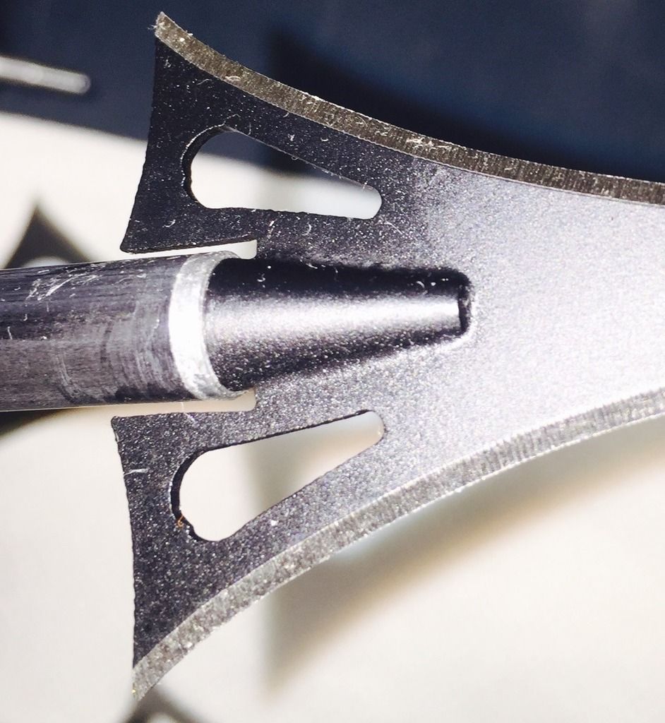

As I mentioned, "The screw on Simmons I have a few engineering issues with. The ferrule is smaller in diameter than the Zombie's 0.346" so there is a step where the ferrule meets the insert. There is also a step where the ferrule tip blends in with the blade. I'll post pics later. "

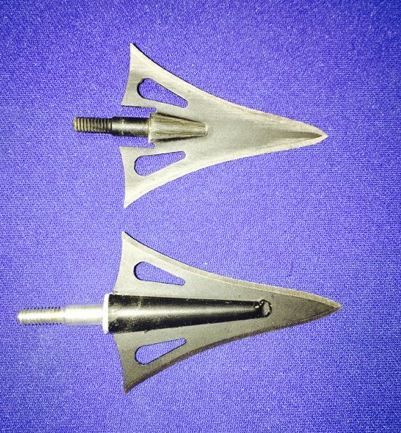

TreeShark vs. TigerShark
The blunt taper of the ferrule meets the blade steel on the screw on version and the undersized ferrule diameter compared to the Zombie shaft.

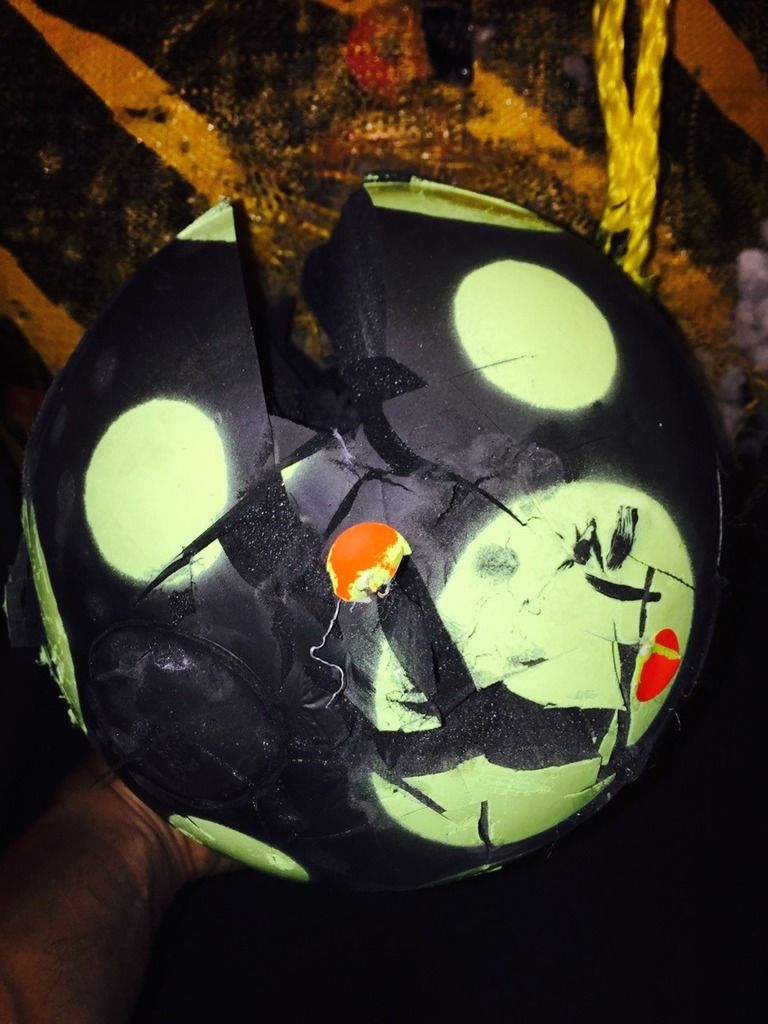

All three, TreeShark, TigerShark, Centaur Big Game...the BG has been scoured a bit from the sand in the Rhinehart ball target. Shooting heads this size does not lend itself to target longevity let me tell ya!

Screw in vs. Glue in insert Simmons Tiger Sharks...

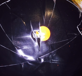

I've beem shooting these heads quite a bit and have narrowed the playing field somewhat. Right now the Tiger Shark and the Big Game fly virtually identically out to 20yds. Odd that, given the BG is 35gr heavier. The single bevel of the BG does indeed impart a twisting as it travels through the target. You can see it on the back side of the target as the entrance and exit holes are not in the same orientation like with the TS. You can feel the arrow twisting as it follows the same path out of the target when you pull it out as well.
2 shots, 20yds, BG and TS broadheads.

Testing these big heads is hard on a target let me tell you. Good thing we have Gorilla Tape!
