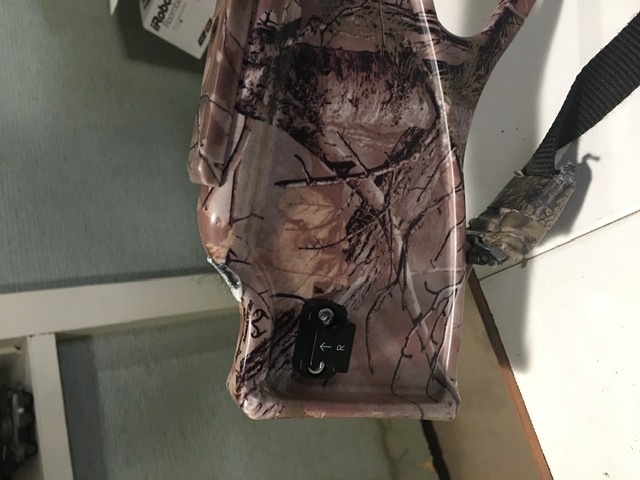

I use the new one on mine, had to drill the holes for the Charger mount plates, but it was very easy. If you want to you could share the crank, you just need an extra set of mounting plates. I have used the older model, it's a bit chunky, but you can find them cheap.

I installed the Charger ext crank on my Matrix 355 by drilling 2 holes on the side of the stock, very easy mod to do.

i have one on my 380 like they said drill 2 holes pretty simple

We actually made a little video showing you how to mount a Charger EXT on a Matrix stock:
https://youtu.be/Eph2JIN0wlk
The only thing is with a longer models like the Matrix 380 you do need to pull the string up to the hooks. Its not a big issue but one guy gave me a hard time about it so I like to make sure everybody is aware of it.

I replaced the cord on my Charger EXT with a slightly longer one so I can use the same crank on a 308 Short all the way up to my old Vortex. Super simple to add the blocks onto the old stocks, and cord replacement was super easy too. Plenty of room on the spools yet.
