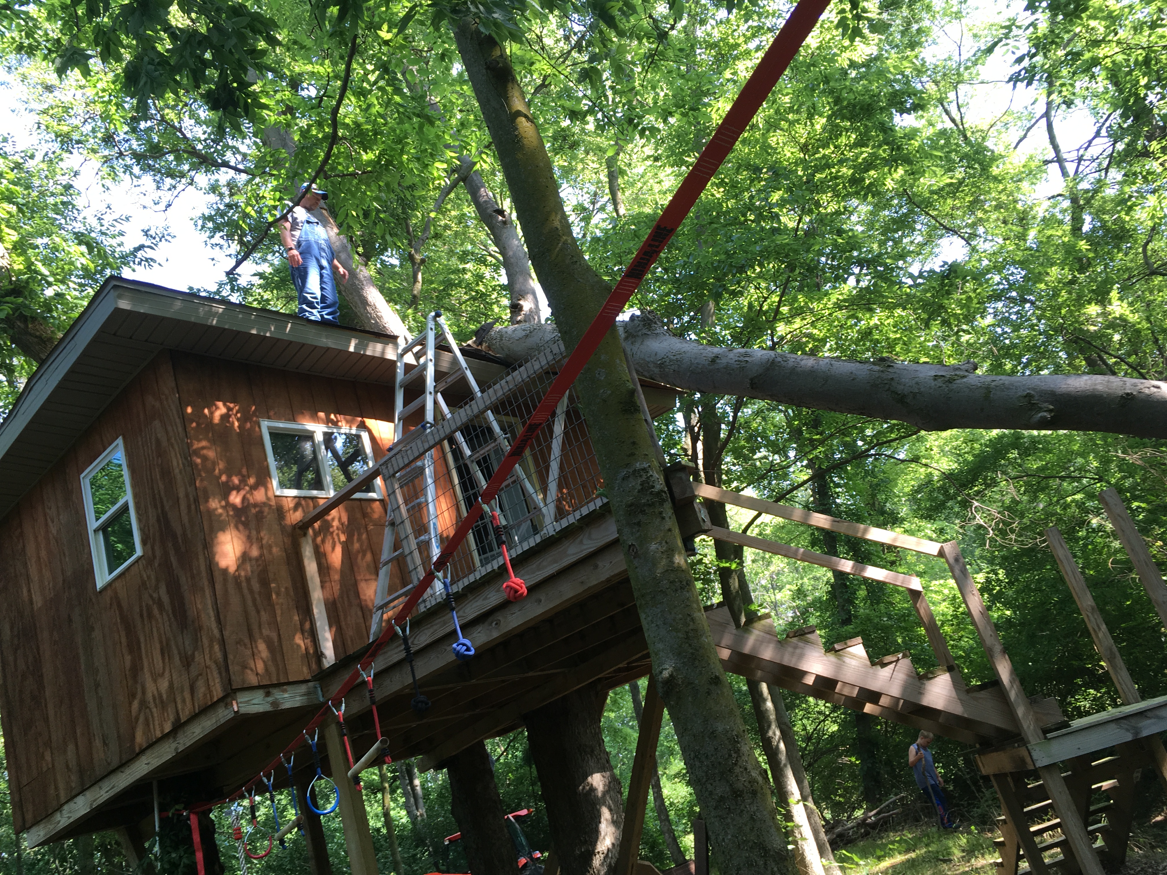

[img][/imghttps://i.postimg.cc/mTd44RyQ/IMG-0405.jpg my sons tree house/blind

Here's the pic folks
Now that's what I call a "tree house"

that's his tree house that I didn't build when he was little. we didn't have a woods tho. I think it's 10'x16'. that tree broke off in a storm and we had to get it off. If it gets cold we hunt out of it some. thinking it's gonna be a bow hunting spot this year pretty regular, since I have an extra Excal.LOL

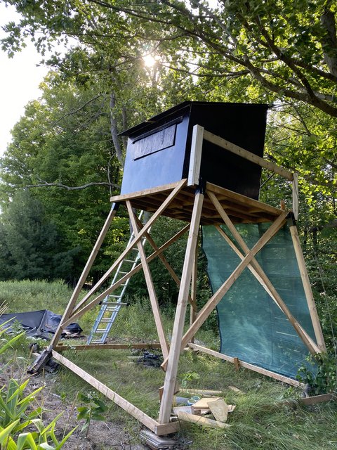

Thabks guys for the suggestions! Its done other than some more leveling and placement of preserved wood as foot pads. Extra bracing with diagonal 2x4s and waterproofing all done. I now have to wait until the waterproofing of the deck dries and I'll put a blind on it.
Joe, I'd surely like to have used western red cedar knowing it will last for 50 to 100 yrs but I figure that might be a whole lot longer than I need. Besides, I can have my cheap moments! I think the cost is between $900 to $1,000 and red cedar prices are obscene!

I'm looking to build something permanent like this now...
Don, where did you get the steel brackets to connect the legs to the platform?
Also, whats the width at the base with an 8x8 platform on 10ft 4x4s?
Thanks!
Thanks!
Re: Hunting platform
You can get them at Cabelas or Amazon. Not a clue what the base measurement are, sorry.
The legs are not anchored into the ground. They sit on multiple layers of plywood and the cross pieces are staked
Platform is 8'X8'. The box is 6'X6' and is set pretty much at the front edge. With a railing on the one side, I can access the front to spray or roll paint. The back has 2' to all me to stand and put a backpack on and a place to put a 20 lb propane tank for my heater. Inside is painted flat black. Walls are 1/4" plywood inside and out. The center of the roof is sealed with roofing membrane. There are 2 windows at front with hinges allowing a plywood flap to flip up independently. Inside I have a platform to put a shooting bag and enough length to have a super stable platform to shoot off of.
I used 14' 4X4s and I think my next one will be 10' high. That height will make it easier to put up and work on.
With plywood inside and out, with the exception of the back wall and roof, I've never used the heater more than a couple of times this year and only for half an hour at a time. When I have time, I'll put in some shelves.
