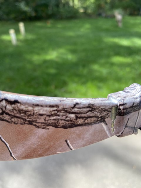

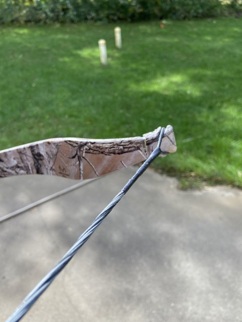

I have a micro 335 and some paint cracks just started near the end of the limb. I would like to post a pic to see if I should be concerned. I tried to post a PNG pic but get a message that the file is too large. Any suggestions here?
Thank You!
Re: How Do I Post a Picture?
Each individual limb is hand made with about 250,000 individual fiberglass strands and some cosmetic features like you describe can be noted . Sometimes we see this at the junction where the limb and tip and glued together and the resin used shrinks during the cure process.
Shoot on without concern .

If it is right where it seems to be a separate part, or the limb tip, maybe an inch or so, that is the coating where the tip is epoxied in. I think all of mine show that to some small degree, and they're fine.

So it sounds like this is not structural and just finish coming off. Does anyone have any suggestions for touch-up paint?
Thank You!
That closeup makes it look like it was the camo coating shrinking during the heating process or an air pocket at the joint. I certainly doesn't look like the limb tip flexed. There is no need for touching up the paint, there's no gain in that.
