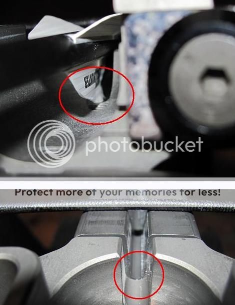

I did notice a few things though. And before any takes this as criticsm I will just say I love the bow and I love it's accuracy, it's a heck of a hunting tool. First, the channel the arrow rests in is not symetrical side to side. One side of the channel has a beveled chamfer, the other a radius. I thought it odd. I also noticed that where the riser is milled out to provide broadhead/fletching clearance, doesn't provide enough clearance for blazer vanes. The cock vane probably interferes with the riser by about 1/8". Enough that the fletching is getting very slightly peeled as it passes over the first riser attachement bolt hole (there is a sharp edge here from the tapping operation). Has anyone else noticed this?

Hi Drew,
The rails are extruded and the top radius can vary slightly but will not influence performance. There looks to be a slight bur on the outside of the tapped hole as a result of the tapping process. This is not typical however, if you would like to give me a call we can discuss this further.

Now thats service Why would anybody not buy an Excalibur with reps like this Awesome is all I can sayExcalibur Marketing Dude wrote:Hi Drew,

Hey Drew!
I have the same problems with the vanes. At the moment I am shooting a tad smaller profile easton vanes. But I am gona get Nap quickspin vanes (3").
Peter, in my case is not the problem tapping bur, but the whole riser is higher than vane rail - slot.
