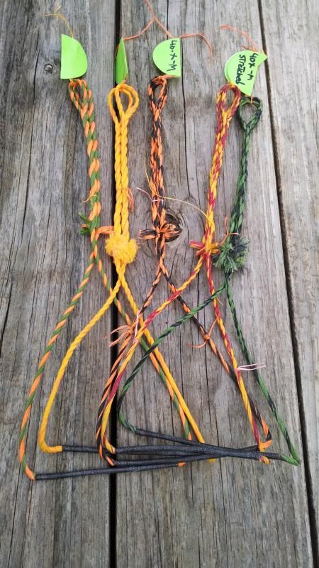

Im using BCY-X string material and really like it so far . I use 40 strands for a string that stretches/creeps very little . I have several people shooting these also and so far everyone's happy.
[URL=http://s154.photobucket.com/user/1longb ... 4.jpg.html]Image
8ptbuk's Flemish Strings
8ptcustomstrings@gmail.com
Re: String advise
Nice work, I'm shooting an endless loop with the 355, and it is doing great. Keep up the good work!
