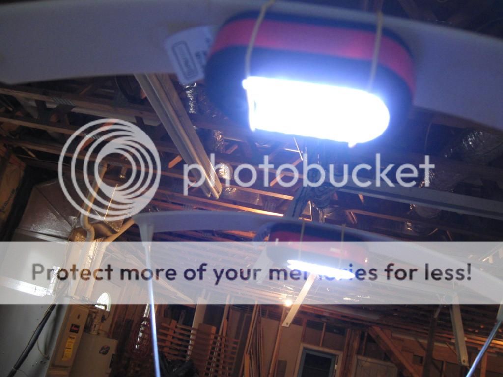

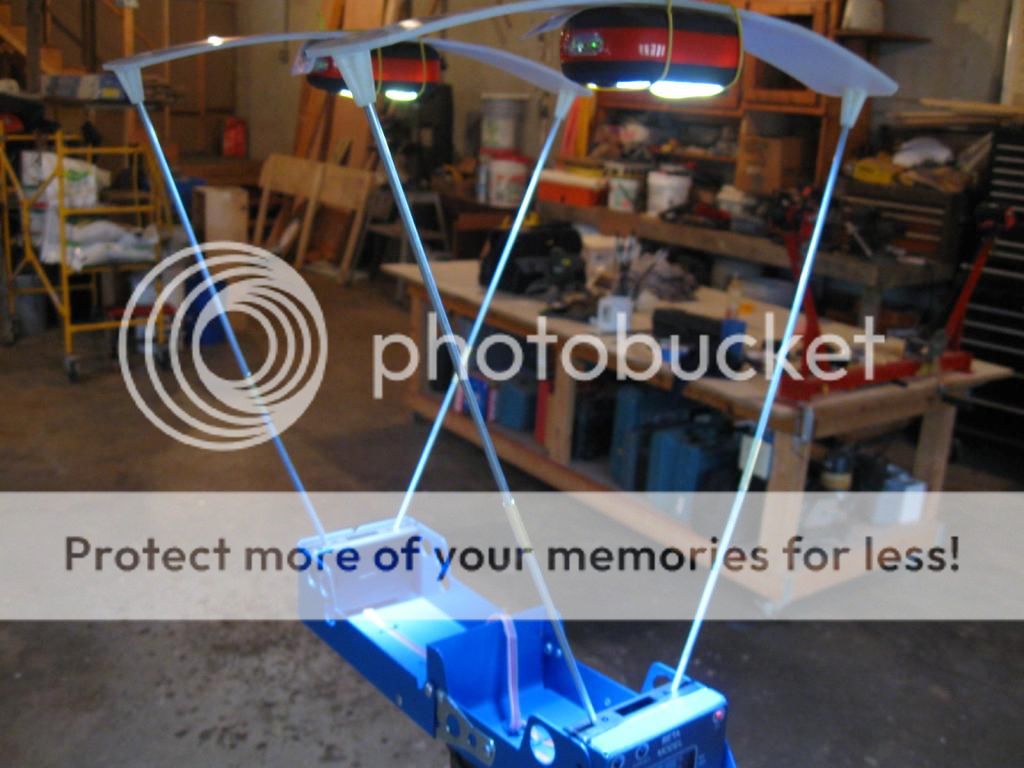

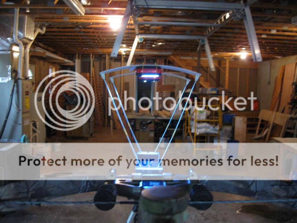

I been working on lighting and think ive hit on something.
I got these LED utility lights from Lowes.($5 each) the pics make it look brighter in my shop than it was.. I turned off the over head fluorescents.
the LEDs cast a very good light on the Chrony eyes. I took 5 shots using 375 gr arrows..had a consistant 334 average.. then I switched to 350 grn arrows 5 shots .. 345 average..
now are these right?..if so my Micro is faster than advertised..took a few more shots and im getting the same thing ..no errors...no crazy off the wall readings . got to go to work so ill fool with it more tomorrow..

Interesting, both the speeds being registered and your light set up.
Chrony looks like an F4, they don't usually make mistakes, it would either be a total erratic number or an error code if it isn't reading proper.
I like the lights idea, cant help but wonder if a string of led Christmas lights would work too, or if they would fall prey to the 60 cycle hum of A/C as well.

Any light connected to an AC source is subject to flickering. Even though LED lights run on DC current, they respond very quickly to changes in current so the amount of flicker will depend on how, and how well the AC to DC conversion is done. That will also determine the frequency at which they flicker if they do. So all LEDs are not the same. In general I would say the cheaper you go, the more chance you have of flicker because they will no doubt do the DC rectification as cheaply as possible. And for things like Christmas lights, no one would really care about flicker. Your setup seems OK (because of the consistency), but the only way to know for sure is to repeat your measurements outside on a bright sunny day and compare results. Good luck.

I forgot yo mention these run on AAA batteries so I don't think there's any flicker.they cast a very clean light..

strum wrote:I forgot yo mention these run on AAA batteries so I don't think there's any flicker.they cast a very clean light..
That might be the ticket right there. Seems good to me. And FWIW I too have seen others posting better than advertised speeds with the Micro. But I am an engineer - so I'd still check it outside :lol: probably twice....and then maybe one more time just to be sure.....
