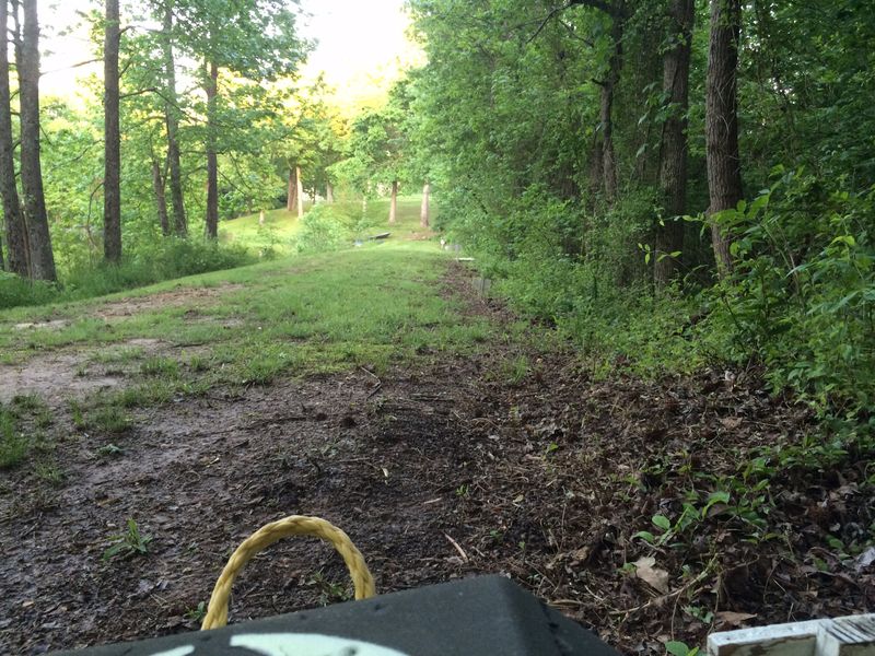

This is a picture of my pond levy which is one my ranges. My card table, "benchrest table" is just in front of the Jon boat 80 yds back down the levy.
1" and less 80 yd groups , with arrows, are just incredible to me. The arrow is there in just over 1/2 second!
