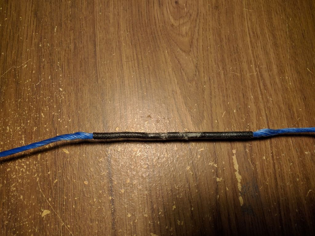

Any Problem's With The Stock String Center Serving
This One Has About 40 Shots On It

Any wax on the serving during the 40 shots ?ROGER THAT wrote:Great Info There Thanks
Any Problem's With The Stock String Center Serving![]()

A Light Coat Of Ex-Wax Serving Wax Was Used After About 25 Shots

Sounds good !ROGER THAT wrote:8ptbuk
