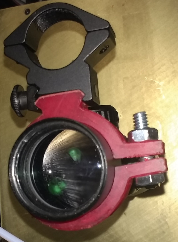

The newer scopes are leaving less and less room to add accessories. The front bell is wide open for adding a clamp with a picatinny rail. I measured the scope front bell and came up with a clamp mount that also has a small section of picatinny rail. With a bit of cad work and some time on the printer I came up with the following.
Here it is with a 1 inch scope ring attached, if there is much interest then I would probably add in a captive nut and a smaller side tab into the cad model. The quick test print feels pretty solidly attached even with the clamp nut finger tight.

That is a nice looking setup, that rimfire should be well tamed by 6 screws per scope ring. I had seen some of the other scope top ring replacements that add a section of rail. Not sure that I would want to pay the additional price that SWFA is asking for their rings. Would rather go with a plastic mount to make it as a breakaway in the event that it ever got dropped or the like. Definitely far cheaper to hit print with a cad model than it would be to replace the scope rings.

Welcome to the forum and yes I would be willing to share the stl file for this. I also put together a version of the ring with a piece gopro connector setup as you mentioned that is what you were wanting to be able to mount onto the bow. It should be a bit easier to mount a gopro with the later version instead of the picatinny version. Send me an email and I can then send you the stl files, my email is my username here followed by [email protected]
