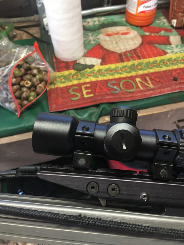

I'll tell him to drop it off at my house so I can go over it. He's not real experienced with crossbows. I check all screws and then remount the scope and see what happens.

He's dropping it off in the morning, i'll check all screws and take off the scope and remount it and see what happens.

I have my friends 355 and as soon as I opened the case I saw the problem.
The scope ring jumped the base on the left side.
Very easy fix. I then checked all screws and bolts.
I adjusted brace height, waxed the string, cleaned the rail, sighted it in at 10 yds for him, were going to meet at the range on Thursday. His arrows are mismatched so I gave him some of my diablos. He needs to order some bees. I’m glad I could help him.
