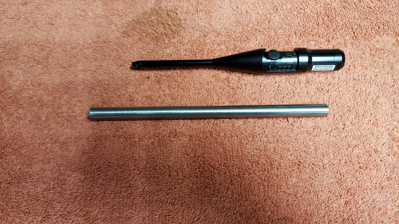

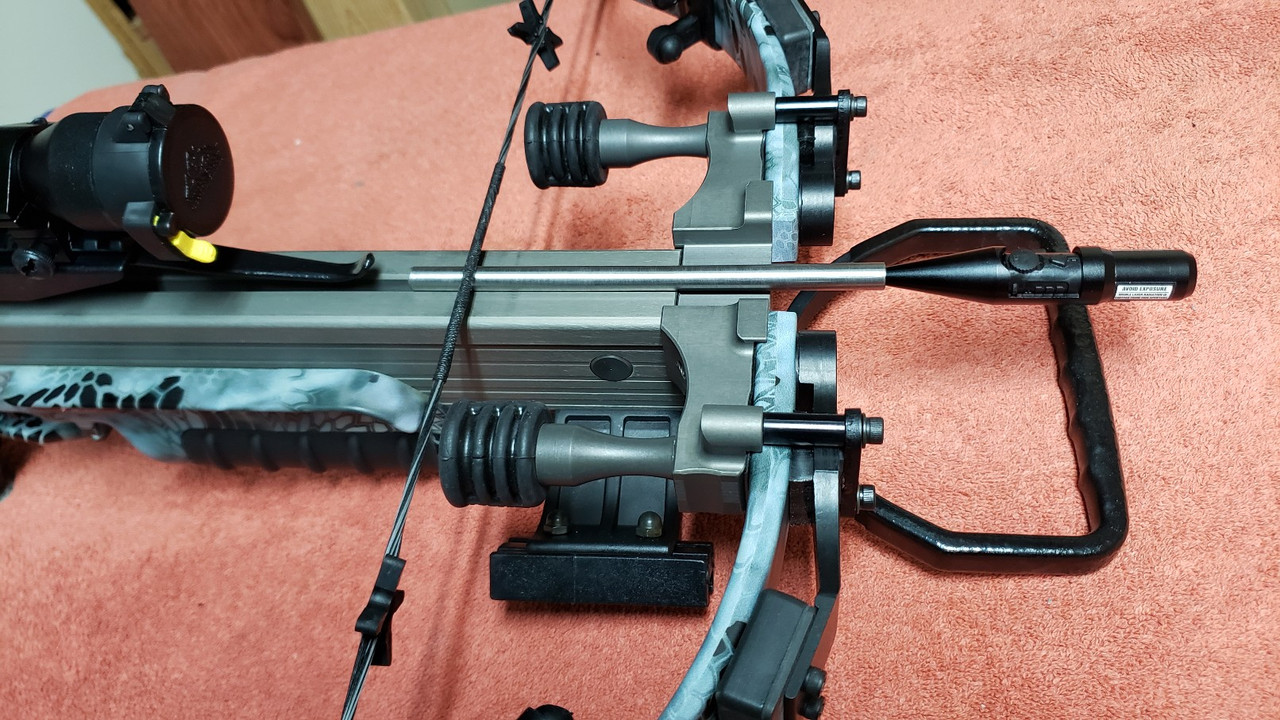

I machined a piece of stainless steel the same diameter as my arrows and reamed a nice slide fit hole to take my laser boresighter I just slip it under the string on the rail and put the laser dot on the target then adjust the scope crosshairs to the centre of the dot. I am within a couple of clicks st 20 yards.

I guess my pictures didn't attach sorry

Image[/img]

For me it's not that it's difficult to sight in the bow with a scope. I came up with this to quickly set up a second scope and my red dot for my Axe in my basement. I have quick detachable rings on my scopes and red dot sight. With not being able to get out to the range during winter I wanted to see what the point of impact was when changing from scope to scope or red dot. Plus I like to tinker. :D
