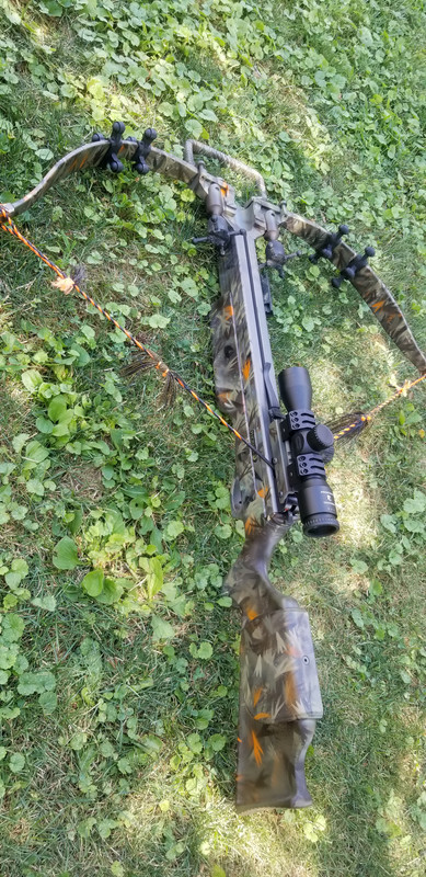

I have an exomax that I would like to personalize by changing the color from the original camo to a solid color like a brown or olive green. This would be very easy to do to the stock- but presents a problem on the limbs because they obviously move back and forth. What type of proccess would be needed to get the limbs customized with a different color? also to address the question of why bother doing this...I just wanna lol thats all I love the look of solid color bows
