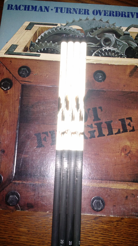

My only rear nocks these days, Black Eagle with the radius on the edge. If I lose an arrow, it's usually stuck in a deer.
Anyway, these are my Go To!
[url=https://postimg.cc/mhg05GkS]
