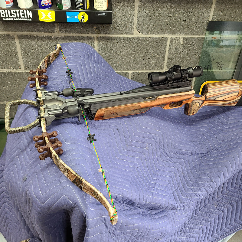

The posters are correct in saying that you can't totally silence a crossbow but if you shoot one of my exo bows with a wrapped stirrup and other silencers it's like night n day plus the Bow is just much more enjoyable to shoot especially in my yard.
I usually shrink wrap the arrow holder didn't get to it yet that's a big cause of noise.
My exo bows loose about 5feet per second wit this stuff no worries
Shooting a 110 grain insert and 125 grain broadhead helps also over the standard insert and broadhead factory combo.

[url=https://postimg.cc/nCSXfCfF]Image

On this set up, the wood stock reduces the most noise.
