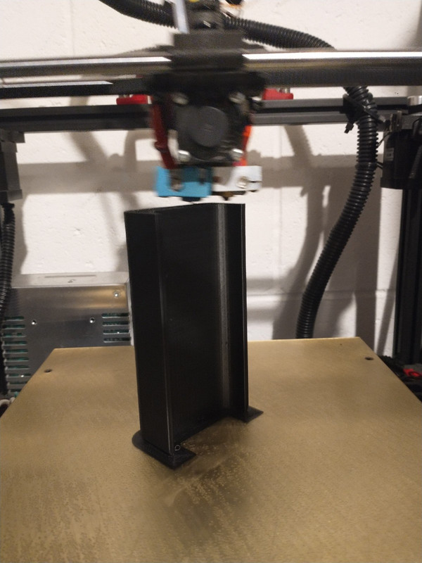

Here it is printing in PETG plastic with a print time of around 3.5 hours at 25% infill.

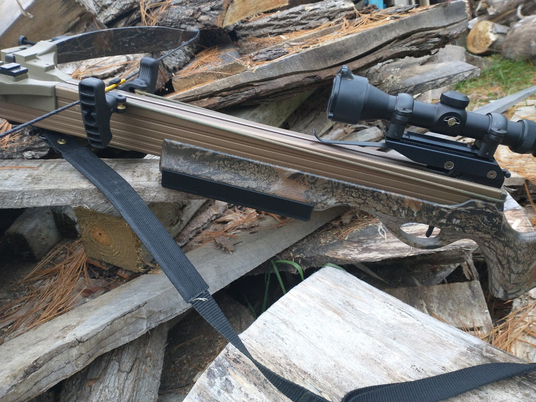

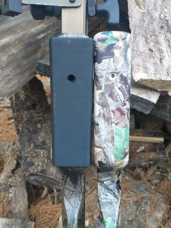

Here is an Axiom stock for comparison with the adapter added on my Exomag, still waiting on some half inch longer round head screws to arrive, although it is a bit of a snap fit onto the stock.

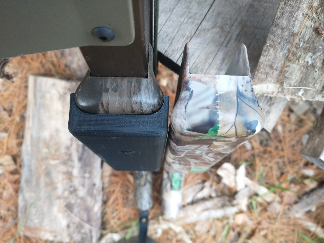

Front view of the adapter on the Exomag with the front of the Axiom as well.
Side view of the adapter on the Exomag. It weighs in at around 73 grams and helps to get the thumb and fingers further away from the string. Nice way of retrofitting the older Exo series bows (ones that had the metal sling swivel in the rear) to keep them out at the range and out in the woods.
