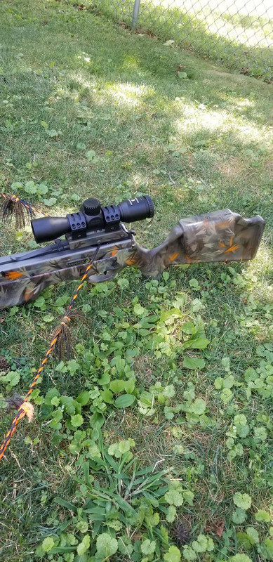

[url=https://postimg.cc/dkbBCHV5]Image[
I loctite my scope mounts with red nasty loctite right from day one.More than likely they are gonna be on for the life of the crossbow.lf l have a problem with the trigger l will just get a new unit and a new mount.. We have the best crossbow in the world ditch the Woolworths factory rings and get it the quality it deserves. To match.l never have had a mount issue. Or a ring issue
These are weaver med. Tactical. There are many other great rings other than these . About $30 bucks .......worth every penny. Jmo
