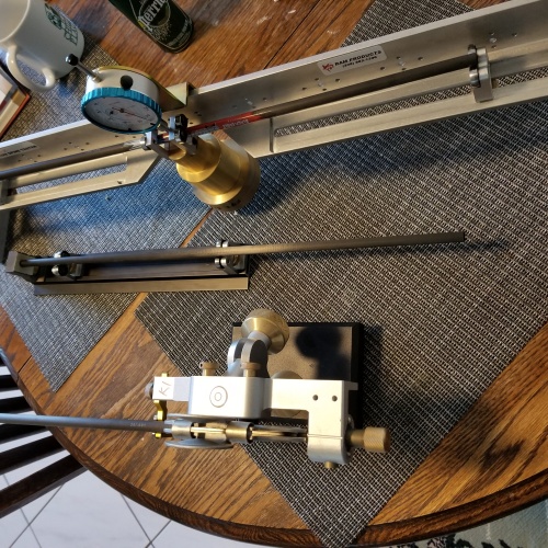

I agree with Boo that Black Eagle arrows are very consistent and do not require spine indexing, especially the Zombie .001 line . However , I index them just to improve the uniform consistency of a group of 12 or 6 where indexing can and does reduce consistency over a non indexed factory dozen.
Above in photo is my Ram Spine tester (top) built to my specs using roller weight hooks instead of the Ram supplied Delrin plastic hooks that exhibit drag.
Also, I had Ram Custom make the roller blocks adjustable for any length arrow which is a desirable feature.
Next, the supporting roller bearings were upgraded to round edge bearing to improve load bearing support.
Lastly, the factory supplied 1.94 lb weight was modified to accept an add a weight to bring the total weight to 3.5 pounds. I feel the extra weight assists determining spine on a short stiff crossbow arrow.
Featured in the middle photo is the Firenock Aero Preparation tool to square ends and on the bottom the Firenock Aerovane Jig for precise fetching attachment and orientation.
