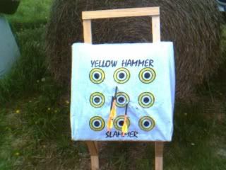

With my Exomax I can group 2"in. at thirty yds freehand.
I use GT 11's, 20"in. with six deg. off-set fletch, Brass front inserts, and aluminium rear, as well as Bolt Wraps. They run around 430 to 440 gr.
This is thirty yds. freehand. With these Bolts mentioned. Kneeling on the ground.

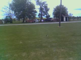

This is forty yds. same bolts, kneeling freehand.
