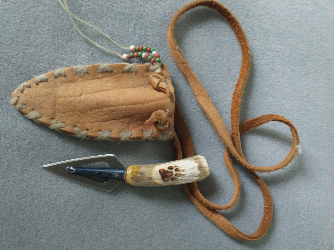

Here is a pic of a neck knife my Brother made for me several years back.
