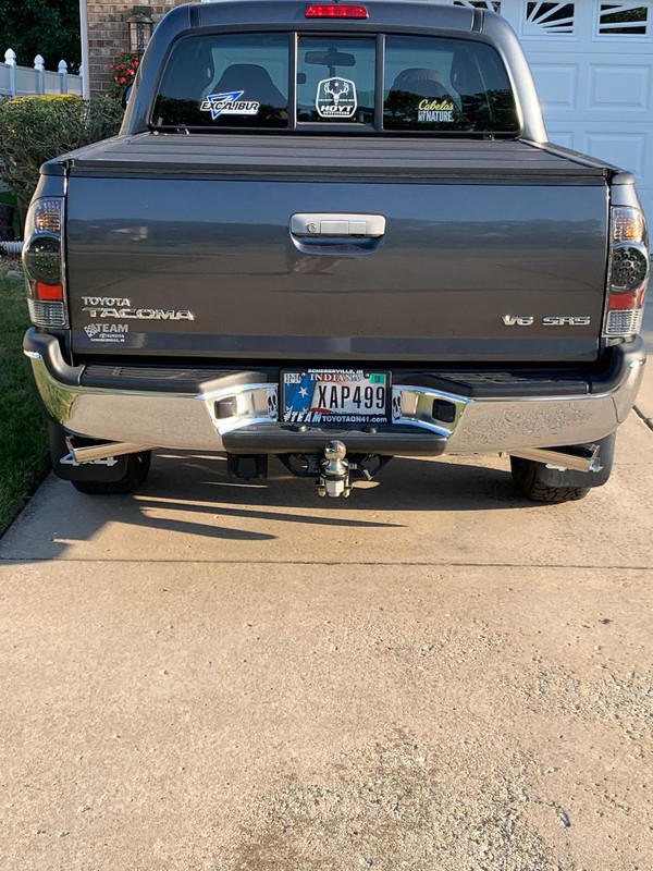

Here is a pic of my baby, upgraded from a Taco last year. I like to hear the exhaust, so I put a flowmaster kit on my Taco, and a couple other goodies recommended by my Toyota nut buddy. Love that Gray from Toyota too!

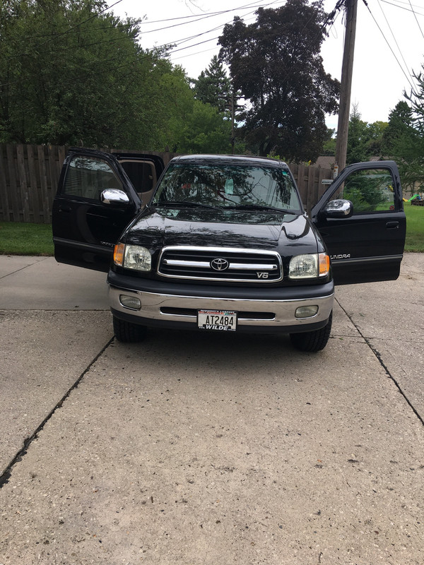

Here is my 20yr old Tundra. Still looks brand new.I have new tires, new plugs, changed rear diff oil, flushed and filled radiator. I have the 4.7 V8, the big 5.7 V8’s suck gas.

Yours looks better than mine! It still starts and gets the job done, IM HAPPY!!

Nice truck Steve!
